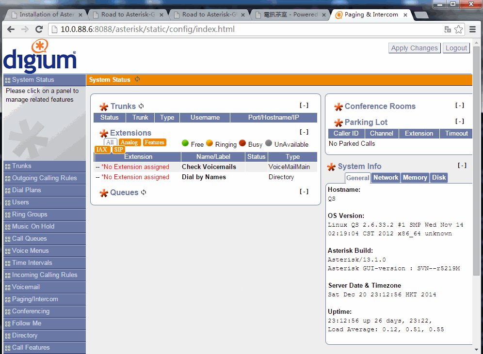

Using the following path to start the Asterisk-GUI
  1. http://10.0.88.6:8088/asterisk/static/config/index.html
using login name=admin and password=admin, it gives
